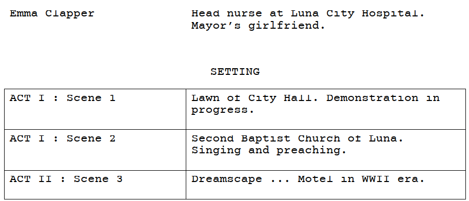

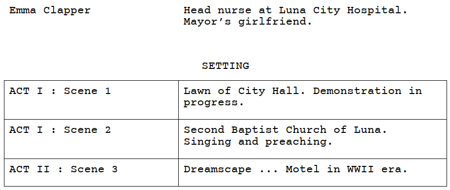

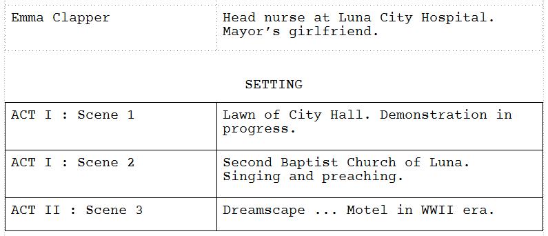

I discovered that a PDF created with the Atlantis PDF generator trims off a pixel or two from the top of text presented in a table. I have included three graphics. These are:
Atlan.RTF.png > It is the original Atlantis text. The font is Courier Prime.
Atlan.PDF.png > The PDF file that Atlantis creates with its own PDF generator.
Atlan.PDF-XChange.png > The PDF file that the commercial program PDF-XChange produces.

NOTE: In my attached graphics in my previous post, I had a table with borders and a table without borders. The trimming occurred in both. I just wanted to clarify this.

Thank you for the quick reply. I am sending you four attached files for your consideration. However, I have some important insight into the problem now.
It appears that the font (Courier Prime) is somehow the problem. Acting on my intuition, I decided to try creating a PDF with Atlantis, but with a couple of other Courier fonts. So I tried (1) Bitstream Courier10 BT (an old but well-known font) and (2) Courier Screenplay (available for free on the Fade In website. Both of these Courier fonts worked fine with the Atlantis PDF generator to produce really beautiful PDF files.
