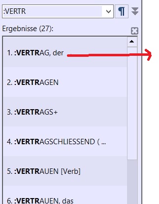

The search feature of Atlantis is already very good and quick but I think it could be made even a little bit more comfortable in the following way:
At the moment it works as follows:
"As soon as you specify text in the Find what box of the panel, it starts searching the target document(s) for the specified text. Found items, if any, get reported through the Results box"
(https://www.atlantiswordprocessor.com/e ... eplace.htm )
So the very useful feature "Find as you type" (Incremental search) is already implemented in Atlantis, but only to a certain degree.
Because in order to see the first search result in the document window I have to click on it in the list with the results or at least hover the mouse over the entry.
To my mind it would be an additional convenience if - parallel with typing - the first search result would already be visible immediately in the document window so that no other clicking or hovering would be necessary.
An example:
- When I type "VERTR" into the "Find what-Box" the first word in my document beginning with these letters (= VERTRAG) would be visible already in the document window.
- When I continue typing "VERTRAGE" there would again be performed a jump to the first matching word in the document window (= VERTRAGEN), and so on.
That's the way in which the search for example in "SumatraPDF" works (at least currently in version 3.5.2).
But I admit that for users with different needs in searching, these "jumps" in the document might be annoying. So perhaps it could be realized only as an option. (?)

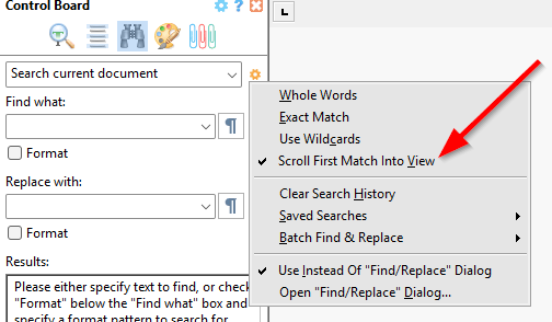

Re: Automatic jump to the first search result in the document window
you folks are the most responsive software engineers I've ever come across
Thank you, Richard!
Please check the new version 5.0.1.4. The “hover” previews are now canceled after a delay, and there is a new “Scroll first match into view” option in the “Find/Replace” panel:
