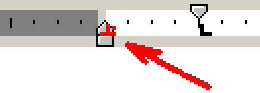

Note that the chapters nineteen through forty-seven of your document have a decimal tab stop 0.01" on the ruler:

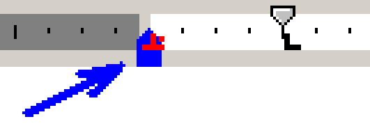

This tab stop makes it difficult to capture the left indent box on the ruler:
