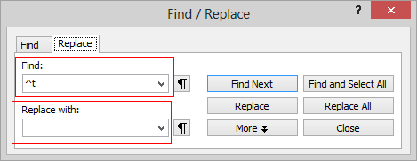

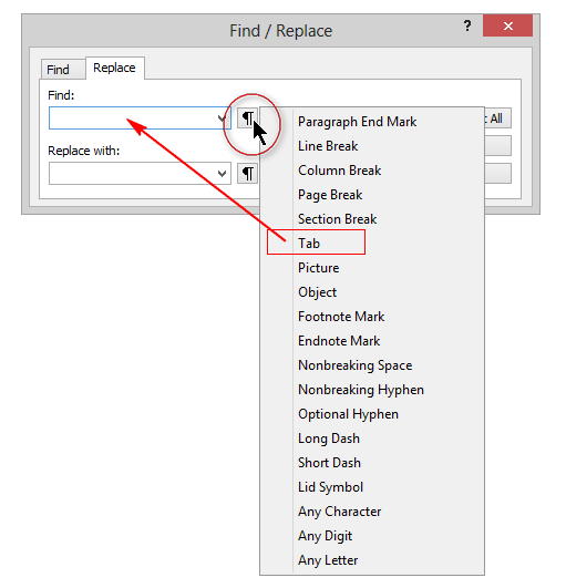

1. Press “Ctrl+Home” to move the insertion cursor to the beginning of the document.
2. Press "Ctrl+H" to open the Find/Replace dialog.
3. Click the small button to the right of the “Find” box, and use the pop-up menu to enter the tabulation symbol into the “Find” box:
4. Clear the “Replace with” box:
5. Press the “Replace All” button.
All the tabulations present in the document will be removed.
