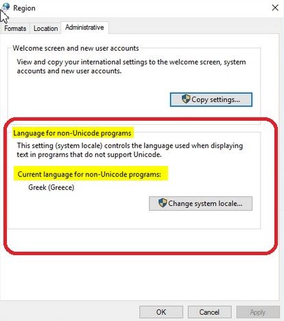

admin wrote:I am not sure that switching to the 64-bit Windows on its own could change anything since Atlantis Word Processor is a 32-bit application.
It seems that you are right. I think I found out now the real reason for the delay. 8) The disappearance of the delay was only triggered by my switch to 64-bit Windows but has not to do with using 64-bit Windows itself.
1.
In Windows 10 both my "Windows display language"* and the first language in the list of my "Preferred languages"* are (and were always) "German (Austria)" (my second preferred language is Greek).
*) Can be found under Settings --> Time & Language --> Language
2.
a)
My "Current language for non-Unicode programs"** was "Greek (Greece)" (so chosen by myself).
**) Can be found via Control Panel --> (View by: Category) --> Clock and Region --> Region --> Click on Tab "Administrative" (in the opening window "Region")
Can be changed by clicking the button "Change system locale..." - see the attachment
---> With this setting in Windows for non-Unicode programs occurs in Atlantis the enormous delay after opening a (bigger) document.
b)
When switching from Windows 32-bit two Windows 64-bit the silly (Windows) system changed this setting (without my knowledge) to "German" (obviously because this is my "Windows display language" and my first "Preferred language" as described above).
And this change of the "Current language for non-Unicode programs" made disappear the delay in Atlantis!
I tested it: When changing back the "System locale" / "Language for non-Unicode programs" to "Greek" the delay in Atlantis is here again!

Settings for non-Unicode programs in Windows

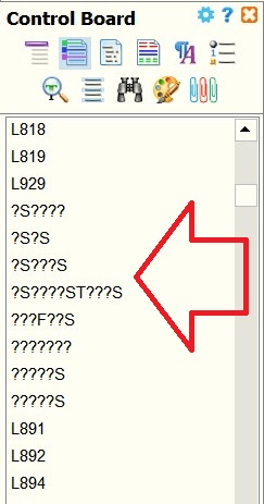

B) Atlantis does not fully support Unicode. Admin confirmed this with a brief sentence above. (More information or at least answers to my questions I did not get in this thread.)
The missing full support of Unicode has as result at least the following issue (hopefully it is the only one):
Bookmarks with non-latin characters (set with MS Word) are not readable in Atlantis. They look like in the picture below. (And of course it is also impossible to add in Atlantis new bookmarks with non-latin characters.)
The weird looking bookmarks are not only a simple visual problem but mainly a practical one: These bookmarks cannot longer fulfill their role as anchors (= references to hyperlinks) within the documents: Hyperlinks that are associated with such bookmarks like "???" often do not open at all or they open on a wrong place.
Finally I had an idea how this issue can be resolved too: I have to rename (within MS Word) all the bookmarks with non-latin characters (Greek characters in my case) into bookmarks with latin characters (transliterating the original expressions). Even if this is unelegant and very cumbersome as I have to do it for hundreds of bookmarks. - So that's currently my preparation work for using Atlantis in the future.
