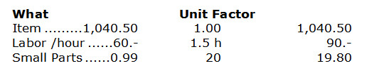

not arguing your example, but I think there are good reasons why Atlantis features decimal tabs, to cover real world examples like the attached jpg. Change these tabs from right-aligned to decimal and you immediately see the advantages of decimal tabs over right-aligned.

- no_decimal_tab.jpg (22.11 KiB) Viewed 22019 times
What about attached “Aligning Numbers (2).docx”? It uses decimal tab stops. The decimal markers are aligned:
