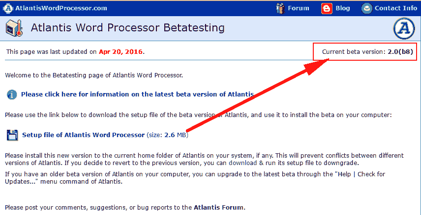

Also, could you please put the beta version on the download page. Sometimes I miss an update, other times I download an identical install.

The beta version number is indicated at the top of the download page. See screen capture below.

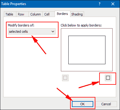

Here is to remove the dotted line:
1. Select the offending cell.
2. Bring up the Table Properties dialog.
3. Display the Borders tab.
4. Click to apply the desired border pattern. See screen capture below.

Old eyes. Don't know how I missed the version on the download page.
Thanks for the tut. It worked.
