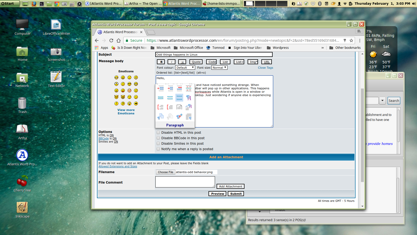

Hello,
I use Atlantis in Linux Mint and have noticed something strange. When minimized, parts of the toolbar will pop up in other applications. This happens as well when I'm in other workspaces while Atlantis is open in a window or maximized on the other desktop. Just wondering if anyone else is experiencing this. Screenshot enclosed.
- atlantis-screen-2-2018.png (964.53 KiB) Viewed 54607 times
