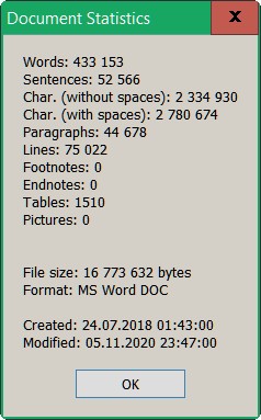

The documents have a size of
a) 45,4 MB
respectively
b) 15,9 MB
With the bigger one it was not possible (or at least I did no wait long enough) to make Atlantis work normally. With the smaller one it was possible after about 10 to 15 minutes! After this time Atlantis worked/reacted in all his functions in a normal speed.
Below is the statistic for the smaller file (which I was able to create after these 10-15 minutes).
(The numbers in the statistics of MS Word are a little bit different – e.g. about 455.000 words – but I assume that's another point. Anyway, the document size is exactly the same according with the statistics of both programs.)
For the bigger file I could not create statistics because of the long delay.

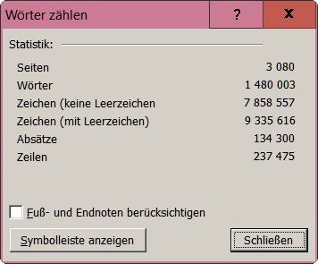

But below you can see the data produced for this bigger document by MS Word. (It is in German - the order is: Words / Sentences / Characters [without/with spaces] / Paragraphs / Lines).
As you can see from the statistics, the files have no pictures (only text), and they have no indexes.
MS Word Statistic - bigger file.jpg (26.12 KiB) Viewed 16803 times
Atlantis Statistik - smaller file.jpg (30.63 KiB) Viewed 16803 times
