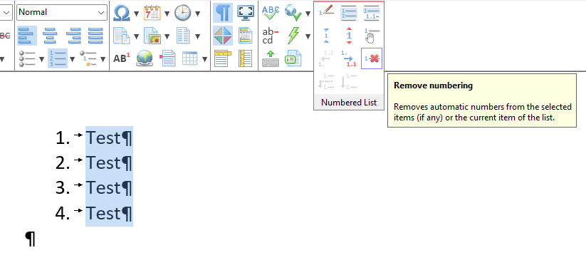

Ctrl+Z undoes the last performed action. I suggested to press Ctrl+Z right after you have pressed Enter and Atlantis created an automatic list.
To remove automatic numbering from the selected paragraphs, you can use the “Remove numbering” button of the context “Numbered list” toolbar:
