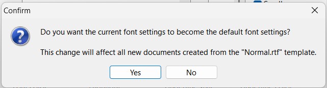

I figured it out; I had to make the changes in Normal.RTF, and now the font styles appear to be updated for new files. What threw me off was the dialog box text when you are changing the default font in other documents:
Screenshot 2025-12-27 104936.jpg (25.1 KiB) Viewed 5702 times

Re: Unable to change default font for headings and footnotes
The "Default..." button in the "Font Format" dialog does not change styles. It applies the current font format to the entire text of the default document template. In other words, the current font format becomes the default font format for new documents. If you create a new document after clicking the "Default..." button, the new document will automatically have the font format loaded to the "Font Format" dialog at the time you clicked the "Default..." button.
