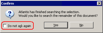

The Find/Replace commands of Atlantis might display various optional confirmation messages that can be disabled with a default answer. Have you ever clicked the "Do not ask again" box in message dialogs of Atlantis:

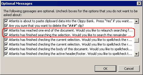

Please choose the "Tools | Options..." menu command of Atlantis, click the "Optional Messages..." button on the "General" tab, and make sure that the following optional messages are enabled (checked) in your Atlantis:
