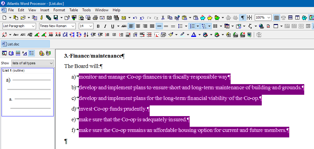

To determine if Atlantis sees any paragraph as an item in an automatic list, display the Lists panel of the Control Board (F6).
Let’s take “List.doc” as an example. If you double-click on “List1” in the Lists panel, you get this:
Note that the list was formatted as an “outline” list but items a) to f) do not actually make up any outline list. They are simple items in a numbered list.

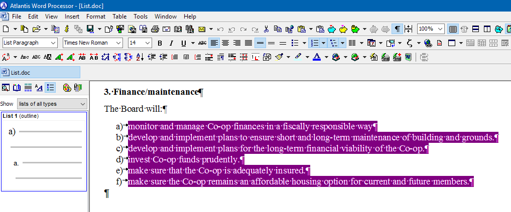

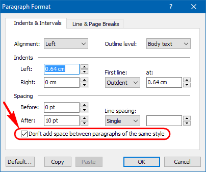

Now let’s suppose that you want to increase the spacing between these a) to f) list items. Keep them selected, and press Ctrl+Shift+G. You should get this:
As you can see, “Don’t add space between paragraphs of the same style” is checked. Uncheck it, and OK out of the dialog to validate your changes. You should get this:
The lists in your document actually would need complete overhaul. But this cannot be done without seeing the whole document.

Thank you, that works.Robert wrote:As you can see, “Don’t add space between paragraphs of the same style” is checked. Uncheck it, and OK out of the dialog to validate your changes. You should get this:
