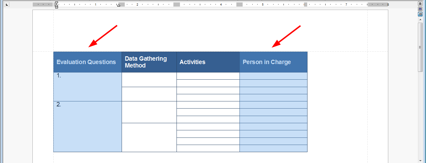

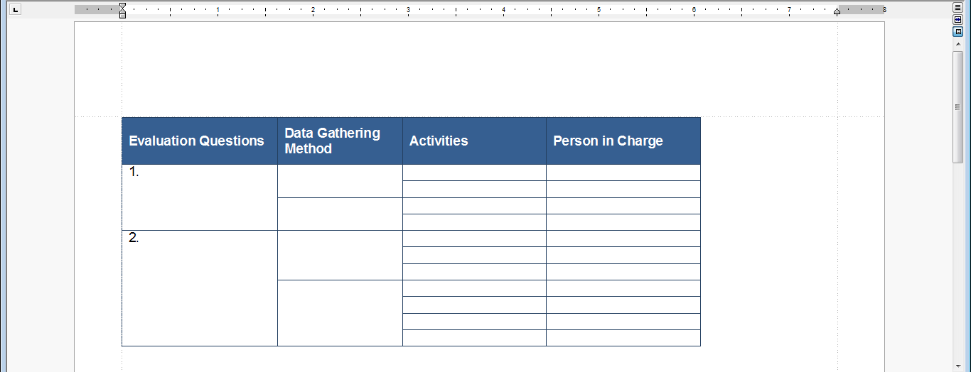

For example, let's suppose that we need to add a new column to the table below, and the "Activities" and "Person in Charge" columns are the ones to provide space for a new column:
Source table
So you should first select the "Activities" and "Person in Charge" columns:
2 columns selected
Then click above the vertical border where a new column should be inserted:
Adding table column
As a result, the space for a new column would be taken from the "Activities" and "Person in Charge" columns. The other existing columns would not be affected, and the table's width would remain unchanged:
