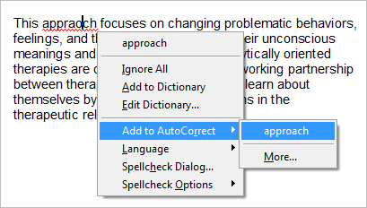

Instead of correcting this manually each time, you can instruct Atlantis to fix this typo automatically for you. This is done by right-clicking the red-underlined word, and by choosing the correct spelling from the "Add to AutoCorrect" submenu:
Adding a typo to AutoCorrect
