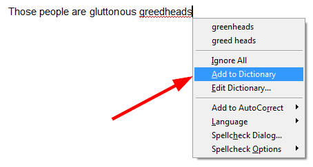

As you know, you can use the Atlantis spellchecker context menu to add a new word to your custom dictionary. This is what the "Add to Dictionary" command is for:
Add to dictionary

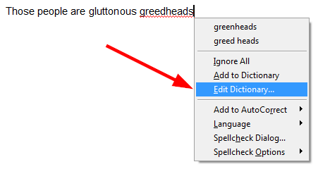

Simply right-click any word red-underlined by the spellchecker, and choose "Edit Dictionary..." from the context menu:
Edit dictionary
Select the "offending" word from the custom dictionary list, and press the "Delete" button.

  1. Right-click any red-underlined word in a document, and choose "Edit Dictionary..." from the context menu. This will display the dialog to edit your current custom dictionary:

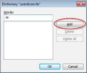

  2. Type in the word to be excluded ("-fir" in our example), and press the "Add" button:

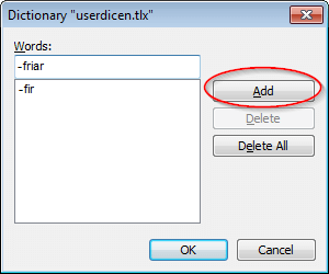

    "friar" can be excluded in the same way. Just type "-friar" in the edit box, and click "Add":
