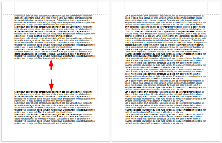

But in a professionally designed document, blank paragraphs should be avoided. There are multiple reasons for this. For instance, most formatting in documents should be controlled through the paragraph styles. When you change a style's properties, this might affect the blank paragraphs. As a result, their height and the corresponding spacing between document fragments might change too. Another reason is that the spacing that you create with blank paragraphs in a middle of a page:
Spacing between text fragments
might look inappropriate if you make changes to the document so that the group of blank paragraphs appears spread over two pages:

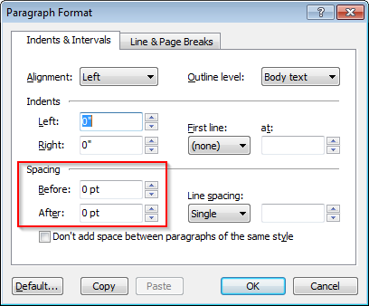

It is much preferable to create spacing between paragraphs through the corresponding attributes of the paragraph format. When you want to add blank space before or after a paragraph, simply click that paragraph, and press CtrlShiftG, or click the "Paragraph format" button of the Paragraph toolbar The 'Paragraph' toolbar :
The 'Paragraph format' toolbar button
then adjust the "Spacing before" or "Spacing after" properties in the "Paragraph Format" dialog:
Spacing before/after paragraphs

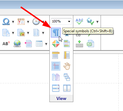

When the "Special symbols" command of the "View" toolbar is checked:
The 'Special symbols' toolbar button
a blank paragraph displays only a pilcrow Pilcrow (paragraph end mark) symbol:
Paragraph end marks

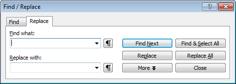

Then press CtrlH to display the "Replace" tab of the "Find / Replace" dialog:
The 'Replace' tab of the 'Find / Replace' dialog

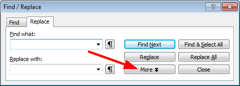

If the "More" button is displaying in the dialog:
The 'More' button
click it to access additional search options:

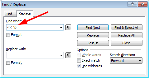

Place the following pattern in the "Find what" box:
<<^p
Search pattern

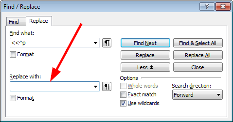

If you leave the "Replace with" box blank:
The 'Replace with' box

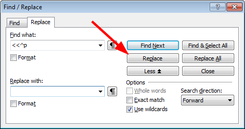

you could click the "Replace" button to delete the currently selected blank paragraph:
The 'Replace' button

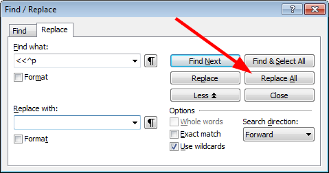

Clicking "Replace All" would replace all blank paragraphs in the document:
The 'Replace all' button
