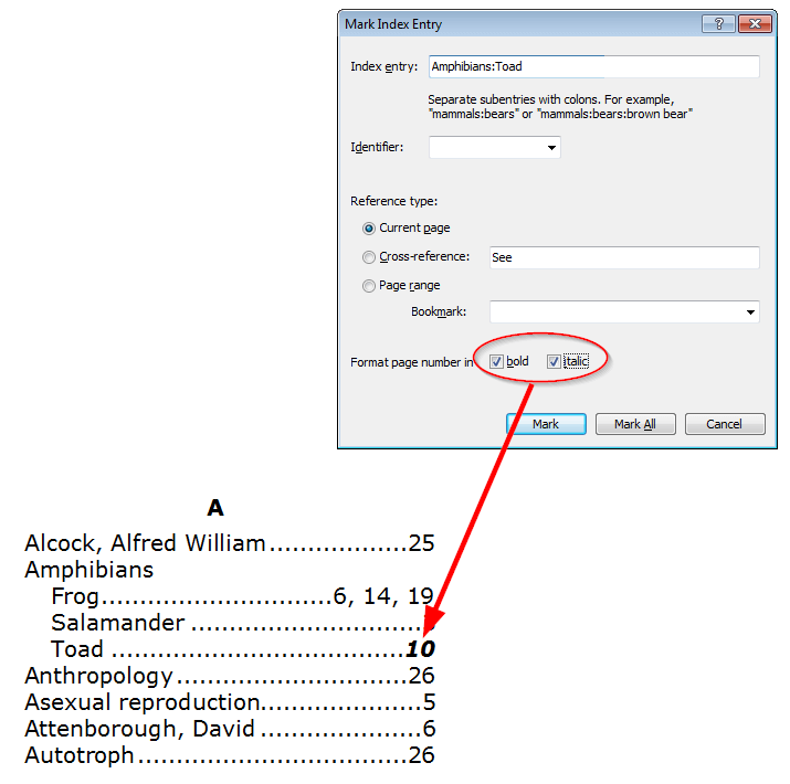

Page number format
Normally the font format of page numbers in an index matches the font format of the corresponding "Index N" styles. But if you check the "Bold" and/or "Italic" options in the "Mark Index Entry" dialog, the corresponding item of the index would have the page number formatted in bold and/or italic irrespective of the font format of the "Index N" styles:
Bold italic page number
