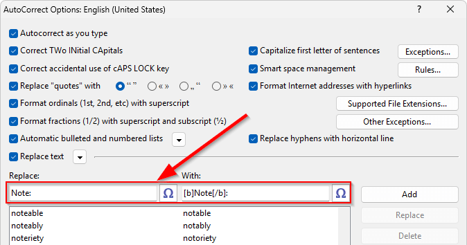

The "replace text" feature of the AutoCorrect tool can not only replace certain text in a document with new text but also apply additional font formatting like bold or underline to the entire replacement text or its part. You can instruct Atlantis to change the font formatting of the replacement text by including special formatting tags in the "with" part of a "replace with" item. For example, if you add a "replace with" item shown in the screenshot below:
A 'replace with' item with font formatting
every time you type "Note:" (without quotes) in a document, Atlantis will automatically apply bold formatting to the word "Note".
