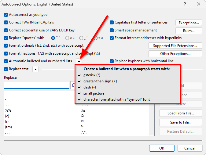

Automatic bulleted and numbered lists
When this option is checked, Atlantis will replace manually typed numbering and bullets with automatic numbered and bulleted lists. Please click here for more details.
By clicking the "down arrow" button next to this option, you can choose when Atlantis should create automatic bulleted lists:
Allowed manual bullets

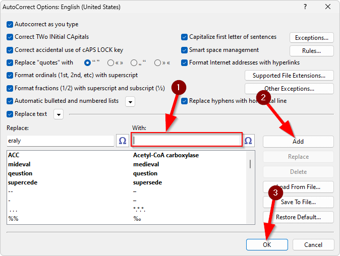

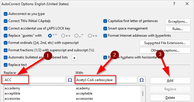

To add a new "replace with" item, type the "replace" and "with" text into the corresponding edit boxes, then click the "Add" button:
Adding new 'replace with' item

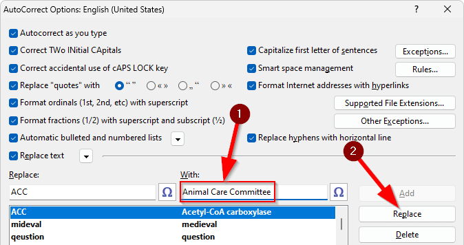

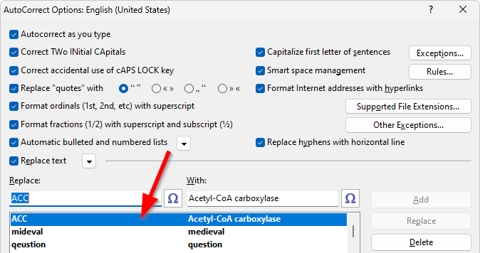

To change the "with" part of an existing "replace with" item, click this item:
Selecting a 'replace with' item
type a new "with" text into the corresponding edit box, then click the "Replace" button:
Changing the 'with' part

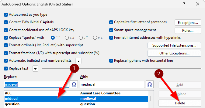

To delete an existing "replace with" item, select it, then click the "Delete" button:
Deleting a 'replace with' item

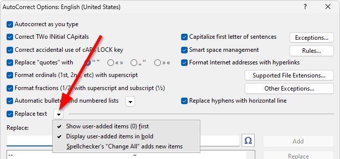

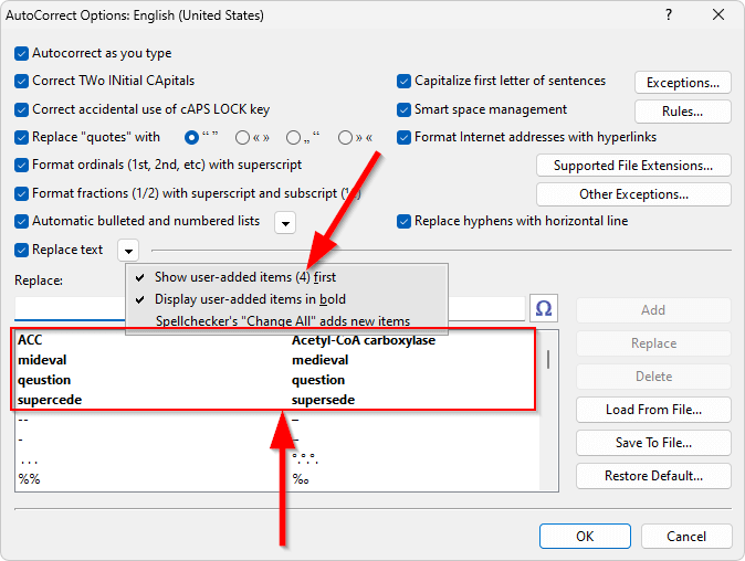

Clicking the "down arrow" button next to the "Replace text" box displays a menu with additional options:
The 'Replace With' options

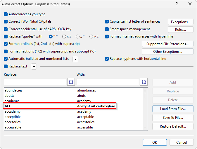

The "Show user-added items first" option tells how many custom "replace with" pairs you have added. When this option is checked, your custom items get displayed at the top of the list:
Bringing user-added items to top
When the "Show user-added items first" option is unchecked, the entire list of "replace with" items displays alphabetically sorted, and your custom items may appear in the middle of the list:
An user-added item in the middle of the list

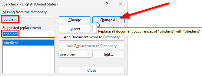

By checking the "Spellchecker's 'Change All' adds new items" option, you instruct Atlantis to automatically add items to the "replace with" list every time you click the "Change All" button in the spellchecker dialog:
The 'Change All' button

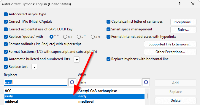

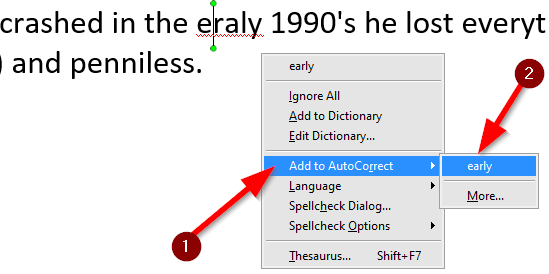

  • There is a fast way to add new "replace with" items to deal with mistyped or misspelled words. Whenever you encounter a word with a red wavy underline in your document, you can right-click it and choose the "Add to AutoCorrect" menu item. If the menu includes the correct spelling for the document word, you can click it to create a new "replace with" item to deal with this particular misspelling:
    Right-clicking a mistyped word
    A new 'replace with' item

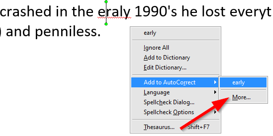

    If the menu does not include the correct spelling, you can click the "More..." menu item to add a new "replace with" pair manually:
    The 'More...' menu item
    Adding a new 'replace with' item manually
