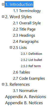

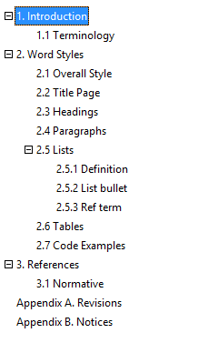

When the "Larger Fonts" option is unchecked, the headings in the panel display with a standard (smaller) font size:
Small font size of the Headings panel of the Control Board

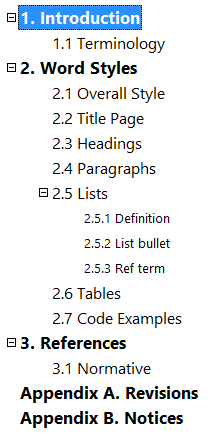

When the "Larger Fonts" option is on, the headings in the panel display with larger font sizes. The largest font size is used for the level 1 headings, then a slightly smaller font size - for the level 2 headings, and an even smaller font size - for the headings of the remaining levels (3 through 9):
Larger font sizes of the Headings panel of the Control Board
Regardless of the font size, the level 1 headings can additionally be displayed in bold when the "Level 1 in Bold" option is checked:
Level 1 headings in bold in the Headings panel of the Control Board
