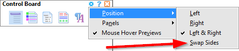

To open the menu with the Control Board settings, click the corresponding button in the top right corner of the Control Board:
The Control Board's Settings button
Through this menu, you can choose the position of the Control Board within the main window of Atlantis:
The Control Board's position options
Choosing the "Left" or "Right" option docks the Control Board to the corresponding edge of the Atlantis main window.
The "Left & Right" option creates two copies of the Control Board at both sides of the main window each with its own set of panels:
Two copies of the Control Board
When you need to exchange the panels of the left and right copy of the Control Board (to move the panels of the left copy of the Control Board to the right copy, and vice versa), use the "Swap Sides" command:
Swap sides
