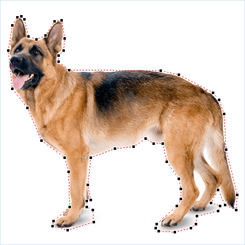

For pictures with the Tight or Through text wrapping style, you can control how text wraps around the picture by specifying the so called wrap points:
Wrap points
These points form a polygon (the shape's outline) that the text flows around:
Wrap points

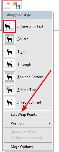

When you apply the Tight or Through wrapping style to a picture with white background, Atlantis automatically computes wrap points for the picture. But you can always manually specify wrap points for pictures with any background. To do so, select the required picture, then choose the Edit Wrap Points command from the menu of the "Picture layout" button of the "Picture" context toolbar:
The 'Edit Wrap Points' command
If the text wrapping style of the selected picture is neither Tight nor Through, clicking the "Edit Wrap Points" command automatically applies the Tight wrapping style.

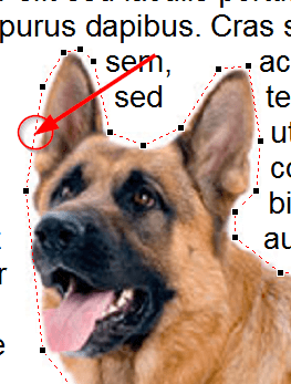

To move a wrap point, grab it with the mouse, and drag to the required location:
Moving a wrap point

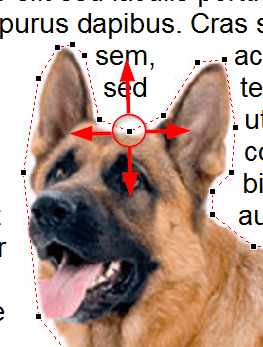

You can add a new wrap point by clicking the dash line between any two other wrap points:
Adding a wrap point
If you do not release the mouse button after clicking the dash line, you can immediately start dragging the new wrap point to another location.

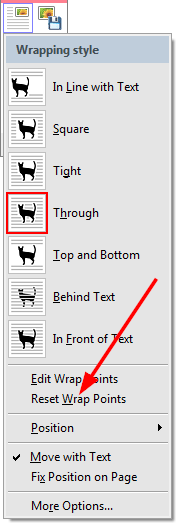

To remove all the added wrap points (i.e. to switch to the default set of four wrap points), you can use the Reset Wrap Points command from the menu of the "Picture layout" button of the "Picture" context toolbar:
The 'Reset Wrap Points' command
Note that this command is available only when the selected picture has custom wrap points.
