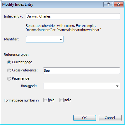

The "Modify Index Entry" dialog
The 'Modify Index Entry' dialog
You can normally access this dialog by clicking the Edit index entry Button image button of the Index panel of the Control Board.
This dialog can be used to modify an existing index entry in the document.
Index entry
In the "Index entry" edit box at the top of the dialog, specify a term or topic that this index entry should contribute to the document's index. On the illustration above, the index entry would add a "Darwin, Charles" item to the index.

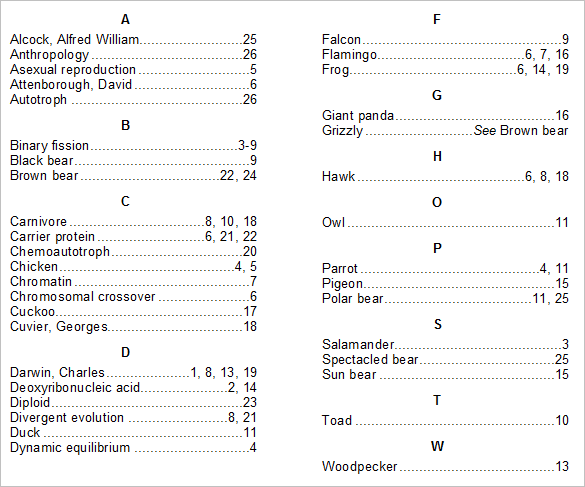

In simpler cases, document indexes have a linear (one level) structure - like on the illustration below:
One-level index

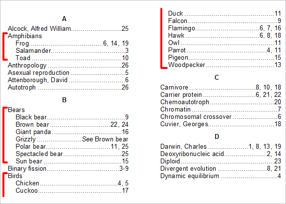

But you might wish to group sets of closely related concepts in your index, i.e. create a hierarchical (multilevel) index:
Multilevel index
To do so, use colons within the entry text to separate subentries of different levels. For example, to have the "Frog", "Salamander", and "Toad" items grouped under the "Amphibians" main entry in the index (as shown on the illustration above), create the corresponding index entries with the following entry text: "Amphibians:Frog", "Amphibians:Salamander", and "Amphibians:Toad". This would create a 2-level index. The 1-level item "Amphibians" would be associated with the "Index 1" style in the generated index. And the 2-level items "Frog", "Salamander", and "Toad" would be associated with the "Index 2" style.
You can have items of up to 9 levels in your index. Just use colons to separate corresponding subentries within the entry text. For example, "Amphibians:Frog:Bullfrog", or "Amphibians:Frog:Bullfrog:American bullfrog".

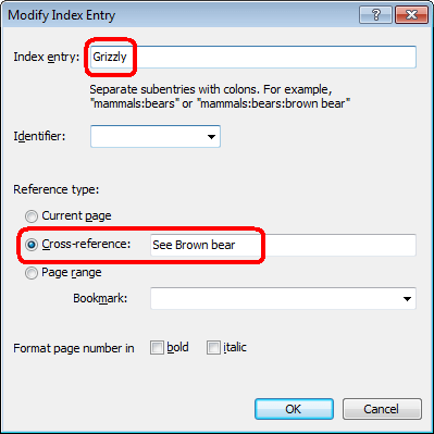

Instead of referring to a page number, an index entry can refer to another entry of the index. If you check the "Cross-reference" option, you can type a cross-reference text (normally starting with "See ") that should be put in the index for this entry instead of a page number. For example, an index entry with the following options:
Index entry cross-reference
would add the following item to the index: "Grizzly, See Brown bear".

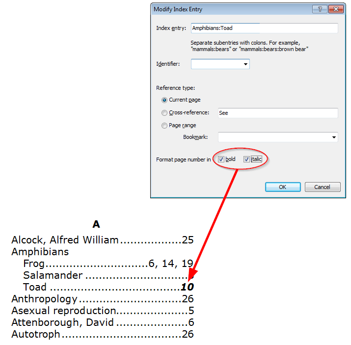

Page number format
Normally the font format of page numbers in an index matches the font format of the corresponding "Index N" styles. But if you check the "Bold" and/or "Italic" options in the "Modify Index Entry" dialog, the corresponding item of the index would have the page number formatted in bold and/or italic irrespective of the font format of the "Index N" styles:
Bold italic page number
