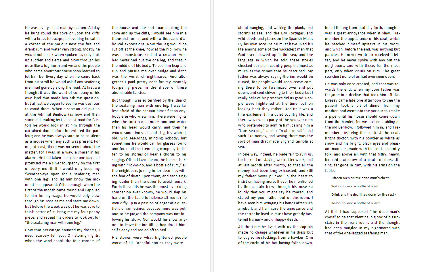

  1. Let's start with a simple document formatted in two newspaper columns containing a novel excerpt:
    Two-column document

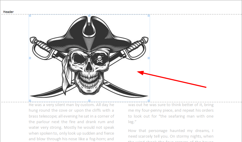

  3. Insert a picture with white background to the header. If the picture is stored on the clipboard, you can simply press CtrlV. Otherwise use the "Insert picture" command of the Insert toolbar The 'Insert' toolbar :
    The 'Insert picture' button
  4. Click the inserted picture to select it:
    Selected picture

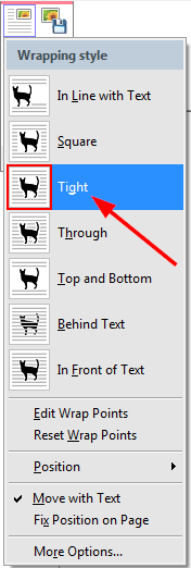

  5. Click the "Page layout" button of the "Picture" context toolbar:
    The 'Page layout' button
    and choose the "Tight" wrapping style:
    The 'Tight' wrapping style

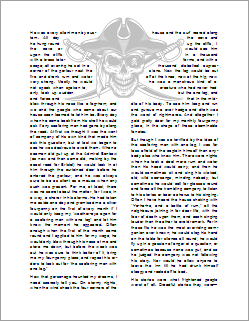

  7. Double-click the document main area to finish editing the header. Now the header's picture displays on each page of the document, and the novel text flows around it:
    Completed document
