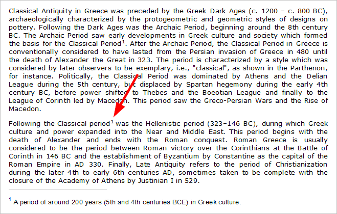

Click the location in the document where you want an additional reference to the existing note:
Location for a new note reference

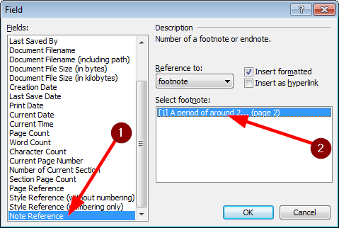

Choose the "Insert | Field..." menu command, or click the corresponding toolbar button Button image.
In the "Field" dialog, choose the "Note Reference" type from the "Fields" list, then click the required note:
The 'Field' dialog
To make a new note reference clickable, check the "Insert as hyperlink" dialog:

New footnote reference
You can create as many note references to the same note as you need.
