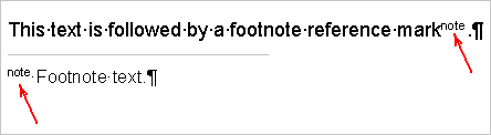

Note reference marks
Each note can be referenced by a number or symbol unique in the document. But notes can also be referenced by numbers or symbols that are specific only in the current page or document section.
With Atlantis, you can insert notes anywhere in a document. You have a wide choice of different reference marks. You can include both footnotes and endnotes in the same document. What's more you can configure footnotes and endnotes to work differently from one document section to the other.

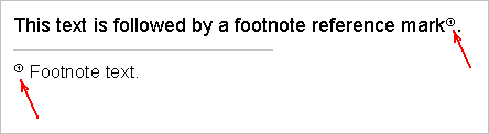

Alternatively, you might want to insert a reference mark displaying a custom text or symbol. In this case, you can type any appropriate text directly in the "Custom mark" box:
Custom mark
Custom mark
You can also press the "Symbol..." button to choose a symbol from the "Symbols" dialog:
Custom mark
For example, you could insert a footnote with the following custom symbol:
Custom mark
Custom mark
Note that Atlantis always displays such custom reference marks with their original text or symbols.

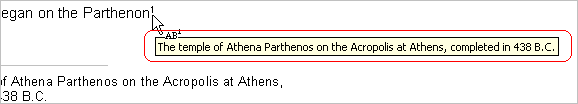

As you know, each note has a corresponding reference mark in the document main text. When you place the mouse pointer over a reference mark, the mouse pointer changes shape and looks like this:
Mouse pointer
The text of the associated note itself is displayed in a small tooltip window:
Note tooltip

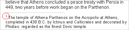

Double-clicking the reference mark switches to the associated note (brings the caret within the note).
Conversely, you can double-click the reference mark displayed by the note itself:
Note text
This brings you back to the associated reference mark in the document main text.

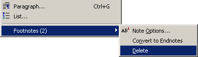

  1. To delete a note from a document manually, you need to delete the reference mark in the document main text first. You cannot delete the note directly. The associated note is deleted automatically as soon as you delete the reference mark in the document main text.
    But there is an alternative way to delete a note: you can right-click the note text, then choose "Delete" from the menu:
    Delete footnote
    Using this method, you can quickly delete even multiple notes. Simply select the notes that you want to delete, then right-click the selection. The pop-up menu will show how many notes are selected, and the "Delete" command will also be available:
    Delete footnote

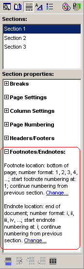

Notes and the Control Board
The Sections panel of the Control Board includes a separate category with the footnote and endnote settings of the current document section:
The 'Sections' panel
You can use this category to view the footnote/endnote settings of the highlighted section, or change them by clicking the corresponding hyperlinks.

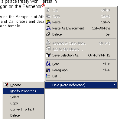

Now you might want to change the formatting of an existing "Note Reference" field, or even to associate it with a different note. This is easily done using the right-click context menu of these "Note Reference" fields:
  1. Right-click the target "Note Reference" field,
  2. Choose "Modify Properties..." from the menu:
    Modify properties
