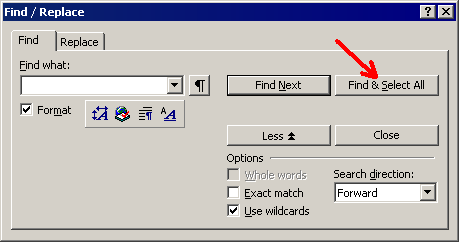

  • Click the Find Next button to find the next occurrence of the text specified in the Find what edit box.
  • Clicking Find & Select All would select all instances of target text in the document as a multiple selection:
    Find and select all
    Like any other multiple selection, the highlighted fragments can be formatted, copied, deleted, moved, replaced with a different text, etc.
    As shown in the above screen capture, a dialog is displayed when the "Find & Select All" operation is complete. This gives you rough-and-ready information on how often a particular word or phrase is used within the selection or across the whole document, depending on the search scope.

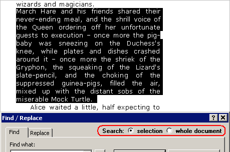

Search scope
Normally Atlantis searches the whole document for the required text. But you can restrict your search operations to the desired text fragment (for example, to a paragraph or a chapter of your document).
So if you want to search only a particular text fragment, select it first before calling the Find / Replace dialog. The Find / Replace dialog would show the search scope options:
Search scope
You can always choose another search scope if desired. All the search commands will be restricted to the chosen portion of your document.
Note that you can search not only ordinary selection but also multiple selection and column blocks.

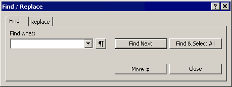

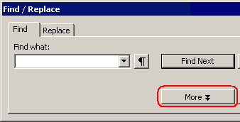

By default, when you choose the Edit | Find... menu command of Atlantis, or press CtrlF, the basic version of the Find / Replace dialog gets displayed:
The 'Find / Replace' dialog
It has a very compact and clean design, and offers only a few basic options.
This basic version of the Find / Replace dialog has a More button:
The 'More' button

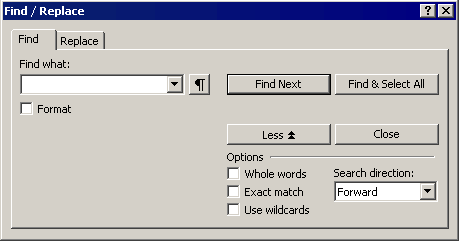

Clicking it displays an advanced version of the Find / Replace dialog with additional options:
Of course, in this advanced Find / Replace dialog the Less button takes you back to the basic version of the dialog.
When the Whole words only option is on, Atlantis will search for whole words only.
With this option off, the search string might be found within longer words.
The Exact match option controls how "sensitive" is the search function of Atlantis.
When the "Exact match" option is unchecked:
  • The search is case-insensitive. For example, the regular expression "<[a-z]@>" catches each word in "The head of NASA".
  • Characters with diacritical marks and the corresponding base characters are considered as identical. For example, searching for "a" will match "a", "à", "á", "â", "ã", "ä", "å", etc.
  • Different flavors of space characters, hyphens, apostrophes, and quotes are considered as identical. For example, searching for a straight quote – " – will also match various smart quotes:
When the "Exact match" option is checked:
  • The search is case-sensitive. For example, the regular expression "<[a-z]@>" catches only "head" and "of" in "The head of NASA".
  • Characters with diacritical marks and the corresponding base characters are considered as different characters. For example, searching for "a" will not match "à", "á", "â", "ã", "ä", "å", etc.
  • Different flavors of space characters, hyphens, apostrophes, and quotes are considered as different characters. For example, searching for a straight quote – " – will match only straight quotes.
Check the Use wildcards box to use regular expressions.
In the Search direction box you can specify a direction for searching:
  • Forward - Atlantis will search for text from the current cursor position down to the end of the document.
  • Backward - Atlantis will search from the current cursor position up to the beginning of the document.
The procedure to change these options is as follows:
  1. If necessary, press the More button to switch to the advanced version of the Find / Replace dialog.
  2. Modify these options as required.
  3. If desired, click the Less button to switch back to the basic version of the Find / Replace dialog.
    Note that these options are automatically saved and will be systematically used by Atlantis until you change them again.

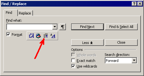

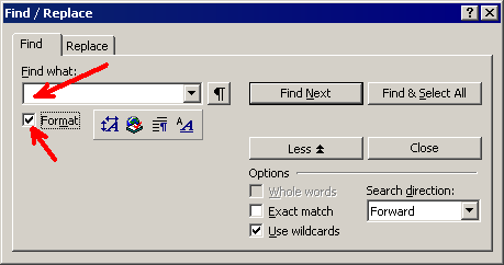

Right under the Find what box in the advanced version of the Find / Replace dialog, there is the Format check box:
Searching for formatting
Check this option to search for text with specific formatting. A small toolbar with format buttons will automatically be displayed next to the Format check box:
These buttons allow you to specify which specific formatting you want to search for.
Tip. You can search for ANY text having the specified formatting. This is done by specifying a format pattern to search for, and leaving the Find what box blank.
On the other hand, if you want to search for a string of text bearing some specific formatting, you must type that string in the Find what box, check the Format box, and specify the target formatting, using the dedicated buttons:
So when the Format box is checked, Atlantis searches for text that has the formatting specified through the format buttons located next to it:

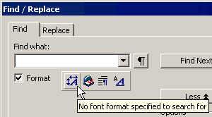

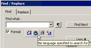

Of course, initially these buttons bear no formatting. This is indicated through their popup hints:
Etc.
You will click these toolbar buttons to specify:
  1. a font format pattern including bold, italic, font face, font color, etc,
  2. a language,

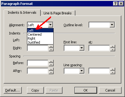

  3. a paragraph format pattern including alignment, indents, spacing between paragraphs, etc,
  4. any style present in the document.
When a format pattern has been defined, placing the mouse pointer over any of these toolbar buttons displays information about the search pattern.

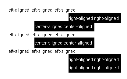

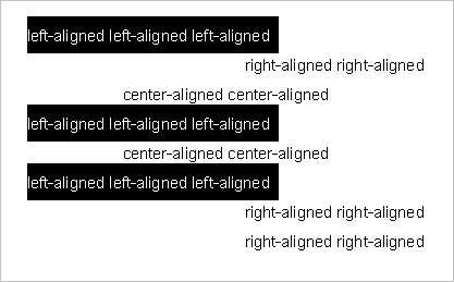

Let's take an example.

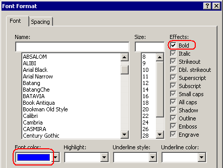

Let's suppose that you clicked the leftmost button in the Find / Replace dialog to specify a font format.
Let's suppose that you chose to look for text with "bold effect" and "blue font color":
Let's suppose that you OK'd out of the Font Format dialog.
The same leftmost toolbar button will show a popup hint with the font format pattern that you specified:
You can choose as many formatting attributes as you want, either through a single formatting button, or through all 5 buttons concurrently.
Now you might want to define another search format pattern. Here is how to proceed:
1. First, uncheck the Format box option to reset the search format pattern. This will clear any previously defined format pattern.
2. Check the Format box again and specify a new format pattern from scratch.
Note that the Format box option is automatically unchecked when you click the Less button in the Find / Replace dialog. This means that any previously defined format pattern is cleared whenever you close the advanced panel of the Find / Replace dialog.
Also note that the Format box is always initially unchecked whenever you restart Atlantis. This means that no search format pattern is defined when Atlantis starts.

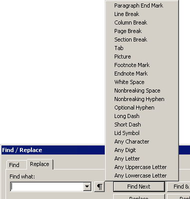

Searching for and replacing with special characters
The Find what and Replace with edit boxes can include not only ordinary text but also special characters.
Special characters that can be used in both the "Find what" and "Replace with" boxes:

Special characters can be typed within the Find what and Replace with edit boxes.
Alternatively, to insert a special character to the Find what or Replace with edit box:
  1. Click a location within the edit box of interest where you want to insert a special character to.
  2. Click the ¶ button next to this edit box:
    Add special symbol
  3. Choose the desired character from the menu:
    Add special symbol

Let's take an example. Let's suppose that your document contains paragraphs with different alignment.
Let's suppose that you want to find all the paragraphs with any alignment except left. Here is how this can be done:
As a first step, you need to find all left-aligned paragraphs in the document. To do so, leave the "Find what" box blank in the "Find / Replace" window, and check the "Format" box under the "Find what" box:
Inverted search
Then click the "Paragraph format" button below the "Find what" box:
Inverted search
and choose "Left" in the "Alignment" drop-down list:
Inverted search
When these options are set, press the "Find & Select All" button in the "Find / Replace" window:
Inverted search
Atlantis will select all left-aligned paragraphs in the document:
Inverted search
Finally, press CtrlKA This is a compound hot key.

, the default hot key for the "Invert selection" command. This command deselects selected fragments, and selects fragments which are currently non-selected. After pressing CtrlKA This is a compound hot key.

, you will get this:
Inverted search
All the non-left-aligned paragraphs in the document are selected, and you can perform various actions on the selection (apply a paragraph style, change paragraph alignment, etc).
