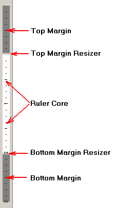

Vertical ruler
The following picture illustrates all the components of the horizontal ruler:
Top & Bottom Margins
Indicate the margins from the page settings of the current document section.
Top Margin Resizer
Allows to change the page top margin of the current document section.
Grab it with the mouse and drag until the required margin achieved.
Bottom Margin Resizer
Allows to change the page bottom margin of the current document section.
