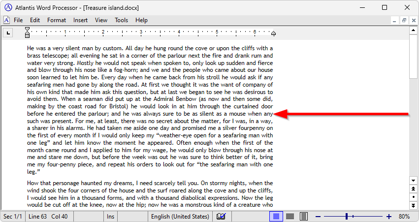

TipYou can select a line of text if you aim at it from the left margin with the mouse pointer, and click.

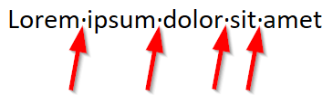

Display space characters as dots when the "View | Special Symbols" mode is on
When this option is on, and the View | Special Symbols mode is on, space characters display onscreen in the document window as dots:
Space dots

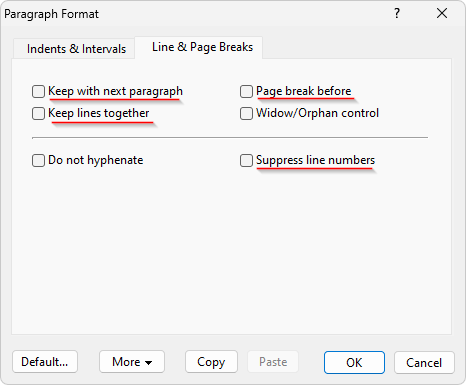

Show paragraph formatting marks ("Keep with next", "Keep lines together", "Page break before", and "Suppress line numbers")
When this option is on, and the View | Special Symbols mode is on, Atlantis displays small rectangular marks to the left of paragraphs that have one of the following attributes enabled within their paragraph format:
Paragraph formatting marks
Paragraph attributes enabling paragraph formatting marks

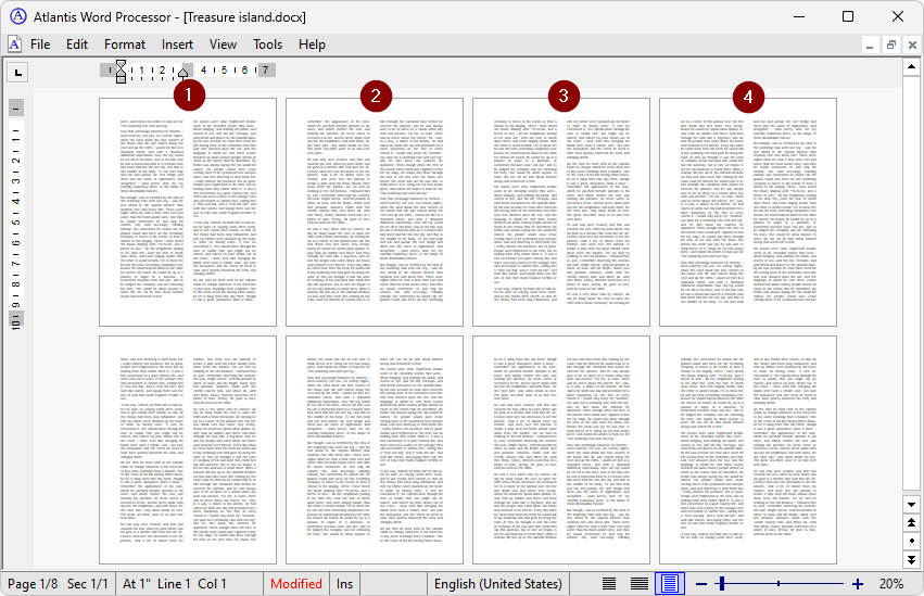

One column of pages under the Print Layout view
When this option is on, only one column of pages always display in the document window under the Print Layout view mode:
One page column
Otherwise, if the available space in the document window allows, multiple columns of pages may be displayed. In the illustration below there are four columns of pages:
Multiple page columns
Note that regardless of whether this option is on or off, Atlantis always displays two columns of pages under the "Two pages" zoom.

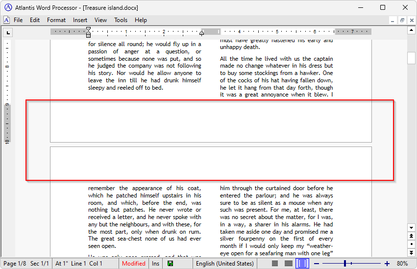

Hide space between pages under the Print Layout view
When this is option is off, document pages display in the document window under the Print Layout view mode with their normal size, and the blank space at the top and bottom of pages is preserved:
Show space between pages
When this is option is on, the blank space between pages gets suppressed for the onscreen display only:

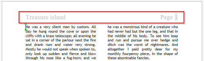

Dim inactive headers/footers
When this option is on, and the cursor is within the document main text, and the "View | Header & Footer" mode is correspondingly off, headers and footers display onscreen grayed out:
Dimmed header
When this option is off, headers and footers always display with normal colors:
Non-dimmed header

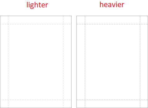

Heavier page margin borders
This option toggles between lighter and heavier page margin borders displayed when the "View | Page Margin Borders" menu command is checked:
Page margin borders

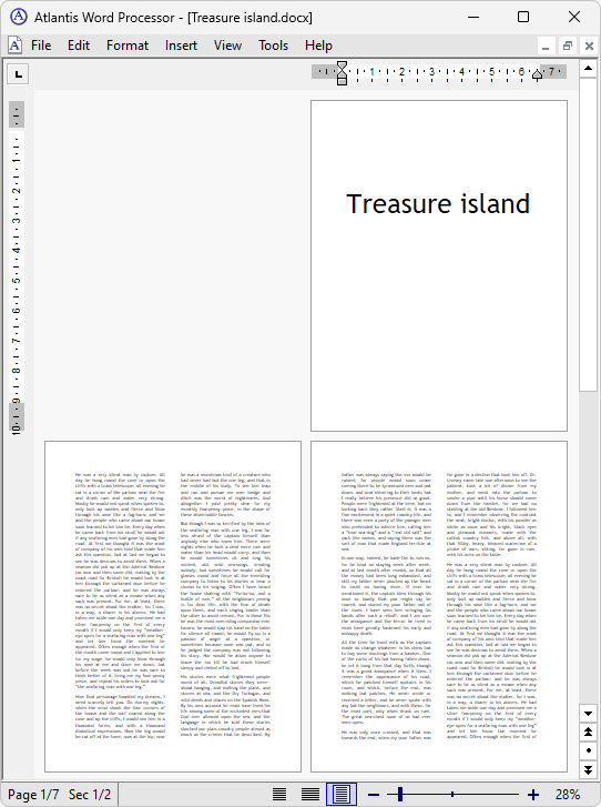

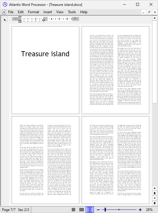

Show title page on its own under the "Two pages" zoom
When this option is on, the document's first page (the title page) always displays on its own under the "Two pages" zoom:
Title page under the 'Two pages' zoom
Otherwise, the title page and the page that follows it display next to each other on the same row of pages:
No title page under the 'Two pages' zoom
