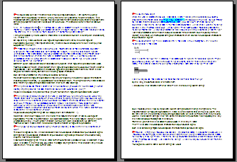

Under the Print Layout View, documents are displayed as a sequence of pages, each page being represented on a separate "paper sheet". Under the smaller zooming factors, several pages are usually displayed together within the same document window:

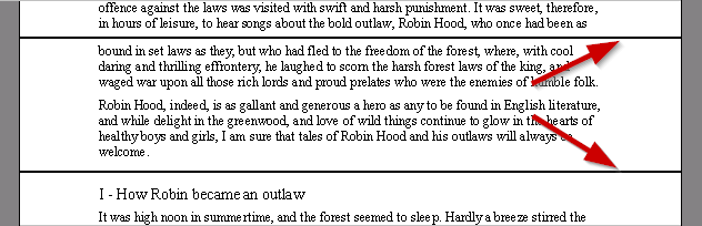

Hide white space
When a document is in the "Print Layout" viewing mode, you can save screen space by hiding the blank areas at the top and bottom of each page, and the space between the pages. Here is how it works:
If you place your mouse pointer over the interpage space right above the top of a page, it will automatically take on a special shape:
If you then give a double-click with that special pointer, the following elements will no longer be displayed on-screen in the document window:
  • the top & bottom page margins,
  • any blank area at the bottom of pages (except for the last document page),
  • the gaps between pages,
  • and the headers and footers, if any.
Even if they are still basically displaying in the standard Print Layout view mode, the document contents then get displayed with far fewer blank areas, and a lot of "white space" removed. In this way, the document text flows uninterrupted along the pages, making work on the document more convenient.
However, note that the actual page boundaries are still shown with a dividing line:
Now bringing the blank areas back into view is very easy. You only need to double-click the horizontal line separating any two pages of the document. This will restore the Print Layout view mode, with all its standard features, including the interpage gaps, among other things.

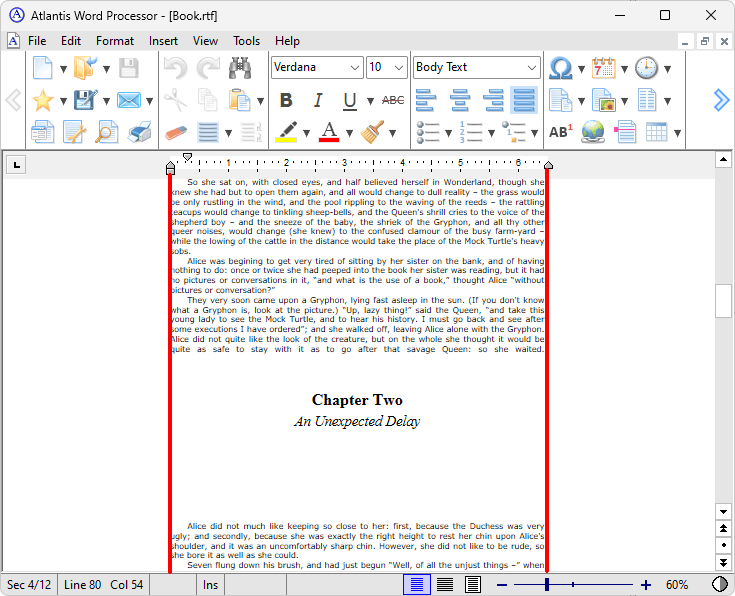

Unlike the traditional Draft view, that displays document contents wrapped to the document page width:
the "Draft view (wrap to window)" mode (the "View | Draft (Wrap to Window)" main menu command) ignores the document page settings, and uses the entire width of the document window to wrap document contents:
